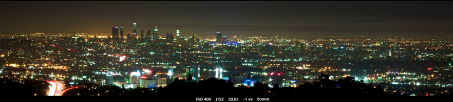

Hey gang,
I wasn't sure what forum to put this in, as it's more than just a body topic.
I just had my first go at nighttime city skyline photography.
Gear I used last night:
5D3
Tripod -- Carbon fiber, smaller travel one. Decently stiff but not heavy. Weighed down with my bag, perhaps 10 pounds or so
Arca head + wimberley plate
24-70 F/2.8L I
70-200 F/2.8L IS II
UV filter (B+W, as a lens protector only)
Didn't use a hood
Corded shutter release
Shot RAW for everything. As the camera was hunting a bit for focus, I switched to live view and did a manual focus at 10x view.
As for the glass, I do have primes, but they aren't long enough. The city was quite far away. The 70-200 got the lion's share of use last night.
No sunset or sky behind the shots, just a very dark brownish haze of city lighting behind the buildings in question.
My questions are myriad (as usual :p)...
1) See gear and method discussed above. Pointers / comments welcomed.
2) Does long exposure noise reduction apply to RAW files, or just JPEGs? If it applies to RAW, how long of an exposure warrants using it?
3) Live view locks up the mirror, right? I should be fine for managing vibrations with that method, right?
4) What is the appropriate exposure for a far off late night city skyline? I presume (unless I go the HDR route) that to get the building silhouettes in view on a dark sky, I will blow out the lighting. But how do I know what to look for in my histograms?
5) I know that darker scenes merit lower exposures, but am I throwing detail away in that process? Is there some mad tribal wisdom in not underexposing to get more detail, then adjusting exposure down in RAW processing afterwards?
6) How on earth do I manage windy conditions with long exposures? Last night, the wind was such that I was stuck with non-ideal settings (1/3 to 1/5 second exposures, ISO 1600, F/7.1, etc,) when I'd ideally like multi-second exposures at a lower ISO. Is there a tip or trick other than tripod positioning and using my body as a windshield? (Use smaller lenses? :D)
As always, your expert guidance is appreciated.
- A
ahsanford said:
Sample from last night. 50% reduction to get it on this forum.
Its always fun when you see an image and say I've been almost exactly there.... although only with a 50 1.4, no tripod (holding camera against a rock) and kids screaming in the car... not ideal - but an image ... need to get back in the canyons next time I'm back.
If I recall - Mulholland between Laurel and Cahuenga ?

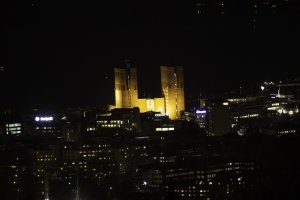

I was shooting in the night last weekend, and I had brought a very sturdy tripod. In my case I was using a 800 F5.6L plus 2xIII teleconvertor (I was there to shoot the moon which was almost full, and ended up shooting city elements, before the dammned moon showed up through the skies (three hours freezing in the wind and below 0 degrees celsius)). What I experienced is that no matter how sturdy a tripod you have, you will get shake due to the wind and the lenght of the lens. I saw this because I was shooting at x 10 in liveview. My buddy and I ended up with our parkas jackets held out to the side to cover the lens, while at the same time using 10 sec. delay to get the shot.
Even then it did not get perfect... I will enclose one of them (as you see I have not done any pp to it yet, not sure if I will bother either). The night was a success for my part, since the damned moon showed up, and I got the shot I wanted @ 1600mm. I will enclose this also.
G.
