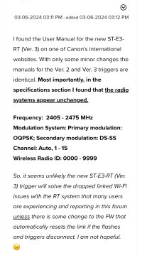

To me they seem to have an identical feature set on the surface. The only thing I can think of is maybe improved resistance to wifi interference?
It's possible that Canon's stocks were running low and needed to put a new order into Hitachi (who design and manufacture all of Canon's speedlites) for a slightly revised version.

How could frequency ranges and modulation change without losing compatibility with current devices? Anyway those specification has nothing to do with the issues, as they are standard ones. What matter is the radio, chipset and the firmware quality - Canon could have (or could not have) changed them and from those specifications one cannot really tell, without dismantling the device and reverse-engineering the firmware.
It's just like saying the new R5 II has a 24x36 sensor at 45mpx. It could be the same R5 one or a totally different one... you can't tell from size and pixel count.
