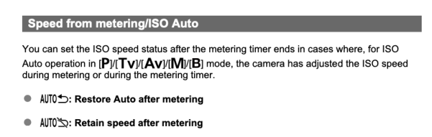

To clarify these issues:
1) Randomly going in and out of auto ISO after FIVE YEARS of people complaining
R5 and R3 will repeatedly alter their ISO status after moments of inactivity during shooting. This is particularly troublesome when using lights (but is troublesome in every other way too).
Eg having balanced the ISO at a specific level with whatever additional lighting you are using, the camera will remeter against your will after a pause in use. Suddenly an ISO set at 640, for instance, will increase to 26,500 as the camera overrides the user's selection and remeters for an unlit space.

For 1. If you actually put the camera in manual ISO mode, it will not change the ISO setting even after a power cycle. If you have it set to auto ISO and change the ISO with the front roller, that is only a "program" change for the immediate shot.
For 2. The camera is doing exactly what you told it to do (whether purposely or inadvertently). Most users would likely find the toggle to be an improvement.
For 3. See 1. Changing from fixed (manual) ISO to auto ISO changes the camera's program, so it may be more confusing than helpful to have it do what you want.

Does the changing of the ISO happen after changing the custom function to prevent that from happening? My R5 and R3 do not change ISO once I changed the custom function to "Retain speed after metering"Screenshot 2024-03-29 at 2.24.01 PM.png

It sounds like the ISO safety switch option is turned on in the custom functions menu? Does the R5/R3 have the option to turn that off?
