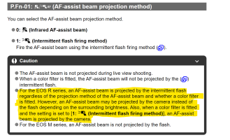

Actually the EL-1 speedlite DOES NOT use the LED lamp for AF Assist according to Canon's manual. The AF Assist Beam will be emitted by "Intermittent Flashes" regardless of projection method. When I tested out the EL-1 with an R5 and R6 bodies the speedlite did emit pre-fires for AF Assist. With my 600EX II-RT it also emitted the AF Assist Beam by Intermittent Flashes/ pre-fires. With my 430EX III-RT set to IR the speedlite also emitted Intermittent Flashes. It seems like the camera can override the AF Assist Beam projection even if the speedlite has an option for both IR and Intermittent Flash/ pre-fires.

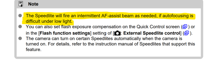

Using my camera Canon EOS R5 in combination with Speedlite 600EX-RF the AF-assist beam doesn’t work at the Speedlite.
What can I do? Maybe wrong settings somewhere? Please help.
The IR Beam from the speedlite won't fire. The speedlite will use "Intermittent Flashes"/ pre-fires for AF Assist. But The camera body decides if the speedlite will fire the AF Assist Beam or the camera will fire its AF Assist Beam.

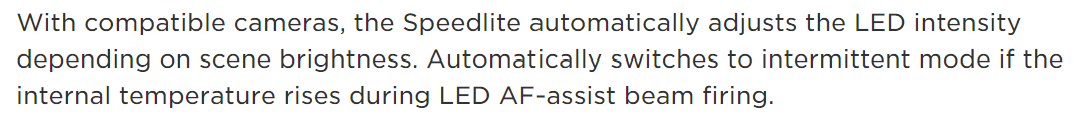

The info listed for the EL-5 says for AF Assist Beam it says "LED Lamp" so I believe that Intermittent Flash won't be used. It might use "Intermittent Flashes"/ pre-fires depending on the lighting conditions as the camera manual mentions.

It looks like the camera can switch between AF Assist Beam emission methods. This is what Canon has been doing with their current speedlites. Intermittent Flash (or on speedlite LED 320EX only) vs Body lamp. LED vs Intermittent Flash firing depending on lighting. This is what's listed on Canon EU so lets see when the speedlite is released. Or at least when the manual is released for the speedlite
