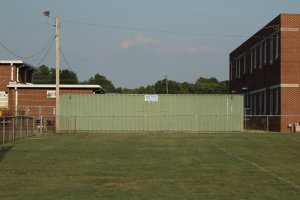

Compare the grass on the lower left to the grass on the lower right. Then compare the trees behind everything on the left to the right. Autofocus was aimed on the sign attached to the shipping container in the center of the frame. [Apparently the EXIF info is stripped by CR. Canon EOS 7D Mark II + EF 70-200mm f/2.8 L IS II. 70mm, ISO100, f/2.8, 1/5000. This was one of several test shots I included on a CD-R when I sent the lens to Canon Factory Service.]
CPS sent it back as sharp and straight, if not sharper, than when it was new. The description of the repair said "electronically adjusted". I'm guessing they biased the "neutral" position of the IS group. The reason I'm guessing that is about a year or so after that my IS starting acting up. When the camera/lens was held at certain angles with respect to gravity the IS would vibrate continuously and rapidly. Looking through the viewfinder made whatever was in the frame look like it was shaking violently. This progressed until there were ever increasing positions where this occurred and I had to send the lens to CPS again to get the IS unit replaced.
