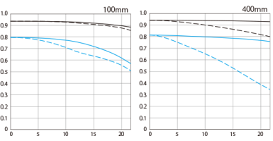

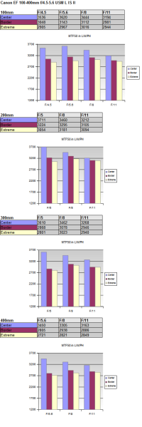

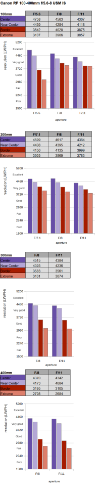

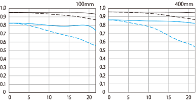

Here are Canon's MTFs for the EF 100-400mm II and the RF 100-400mm, and Opticallimits charts. Remember the EF is on a 21 Mpx sensor and the RF on the much more demanding 45 Mpx sensor for opticallimits. It's not night and day between them in the centre or at the edges.
