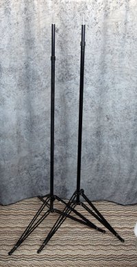

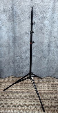

Over the years, I collected at least 25 stands most vintage US made stands. I sold many of them but kept 3 or so pairs of the ones I liked best. I believe that Matthews, Tiltall, and Wescott were the best. The better ones had legs that could adjust widely for stability or you could go for less space and still have good stability. They all had additional braces to reduce any deflection in the legs.
I'm not sure that all of these are still available.
Matthews
Tiltall
Wescott
