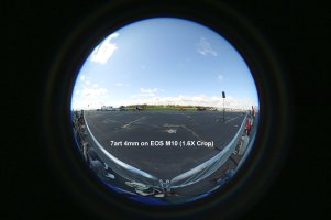

OK so my 1st test images. This thing is wide! Much wider than the 8-15mm fisheye. That's a big plus.
On the downside, the image circle is small even on th 1.6X cropped sensor of the M10. You can see it does not come real close to the top and bottom of the Frame. I'm holding the camera with the front of the lens just above the fence.
