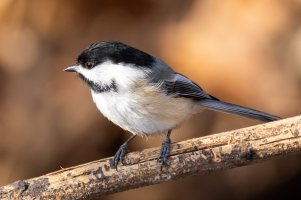

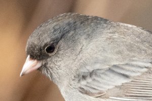

The next day compared to the above photos. Similar time of day (~3 pm). Same bird feeder, ~27 ft/8 m distance. This time, I was trying to compare the 100-500 w/1.4TC against the 200-800 with and without the 1.4TC.
Unprocessed headshoot. all--R5, 1/1250, ISO 3200, f/10 or f/13 (200-800 w/TC)
RF 100-500 w/1.4TC @ 700 mm
A second one just as that first of the Junco isn't great...
RF 200-800 @672 mm
RF 200-800 w1.4TC @990 mm
RF 200-800 w1.4TC @1120mm

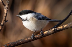

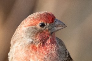

A few other comparisons:
Cardinal Headshots:
Unprocessed: 100-500 @700
Unprocessed: 200-800 @ 990mm
Processed: 100-500 w/1.4TC at 700 mm
Processed 200-800 at 672 mm
edit..and @1120 mm
Two great lenses. In the grand scheme of things, the 100-500L is extremely good and the above images are very much usable especially once cropped to the entire bird and processed. But my conclusion is that the RF 200-800 is winning out, especially with the 1.4xTC. Which, I am somewhat relived by (confirmational bias?), as I already bought the 200-800. But, I am actively looking into selling my EF 100-400II and upgrading to the 100-500L. I can get more reach than with the EF 100-400II, plus it is smaller and lighter than the 200-800. I travel a lot and the RF 100-500 would both pack better and fit in most hotel safes.
So, the 100-500L being extremely good, but the 200-800 being slight better on the R5...is essentially what @AlanF has already told us :). But, just some illustrations from my bird feeder.

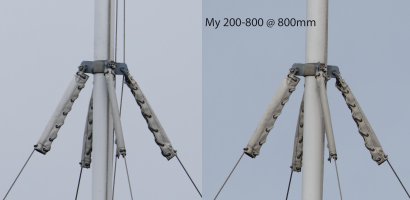

I posted earlier that the copy of the 200-800mm that I was eventually able to buy was sharper than the copy I had first tested. Yesterday, I had the opportunity of taking more shots of the target rigging under very similar light to previously, but with different sky/cloud colour. The difference in sharpness and contrast at both 800mm and 500mm is noticeable. You simply can't rely on sites that just look at a single copy of a lens - the only one that counts for you is the one you have, and you have to be able to test lenses before final buying.
