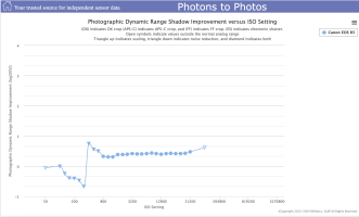

Which ISO ranges are you planning to use? The R5 is ISO invariant in most of its ISO range, so changing exposure in post has the same effect as changing ISO during capture.

Very good point! It is isoinvariant from 800-51200 so if you set it to underexpose at iso 800 you have six stops to 51200 from just one exposure without any need for bracketing. And, it wouldn't be too bad even starting at iso 50.
