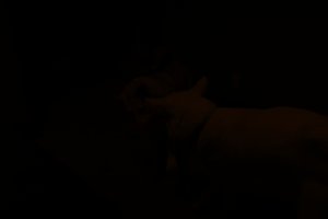

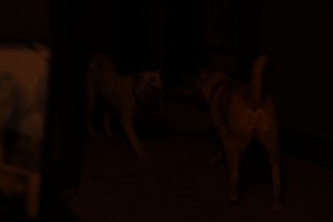

Something isn't right. Do other Canon speedlites cause this too. This shouldn't happen at all. What was the ambient lighting in the picture because it looks quite dark. The camera meters the scene without flash as if flash isn't being used. Did the speedlite fire an AF Assist Beam. Heavy use of the AF Assist Beam can cause the speedlite to discharge quickly. Note with R series cameras the AF Assist Beam emission method from a speedlite is Intermittent Flash Firing. The IR grid will not be projected all. Even if the speedlite has a personal function for both IR and Intermittent Flash Firing. Intermittent Flash Firing takes precedence over IR. But note depending on ambient lighting an AF Assist Beam maybe projected by the camera instead of the speedlite.
That's what I was thinking. Other brands of flash work fine on both cameras, it's just the Canon flash that does not. Even with the new adapter. There was ambient light, but I had selected setting so the flash would have to fire and it did, just was not captured on the photos.

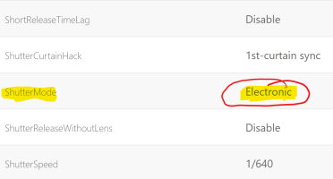

Full Electronic Shutter is NOT compatible with Flash photography. Retest with EFC or Full Mechanical. The speedlite will NOT fire in full electronic shutter mode.Screenshot 2023-03-17 174947.png

Full Electronic Shutter is NOT compatible with Flash photography. Retest with EFC or Full Mechanical. The speedlite will NOT fire in full electronic shutter mode.View attachment 207964
I’m still not sure what the problem here is, I will try and replicate his flash settings on my camera today, time permitting.
But to clarify, the camera being used is an R3, which CAN fire a flash with full electronic shutter. That’s made possible by the fast readout speed of the stacked sensor, although the max sync speed of 1/180 s is slightly slower than with EFCS (1/250 s) or full mechanical (1/200 s).
Still doing the same thing in full mechanical shutter mode. he flash does go off, but the photos are dark.

Those are mainly default except for HSS (not clear if your slow synchro is 1/180 auto or fixed so I tried both). Couldn’t replicate your issue when matching your settings with one of my 600EX-RTs (not MkII).
In a dark room (the EVF looked like your second shot, could barely make out the scene) focusing was with the camera’s assist lamp not the flash, and was snappy. Tried shutter speeds of 1/60 s (auto) and 1/1000 s, ISO of 6400 (auto) and 200.
It then occurred to me that maybe I was making it too easy because I used the lens that’s usually on my camera at home, the RF 28-70/2. So I switched to the RF 100-400 (f/5.6 at the short end) and repeated. Same scene, but the EVF was black. Focusing strobed the flash head main tube for assist. Shots still came out with proper flash exposure.
I presume you have good batteries in the flash. Maybe try cleaning the flash contact pins (cotton swab, isopropyl alcohol). Some things to try might be resetting all the flash C.Fns (mine are all default), resetting your camera to factory settings (you can copy your settings to a memory card first and restore them if the reset doesn’t help).
