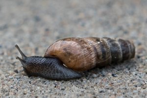

JBSF said:
Can your or anybody else here post insect photos taken with the Sony combo? Or the Sony with the Canon 100-400?
At 100mm or 400mm?
It's a rainy, cloudy day and I don't know if I can find any photogenic insects, but will if I do.
Sun came out, but no insects readily posing. Here's a decollate snail at 400mm, roughly minimum focus distance, though shot handheld with AF, so focus isn't as good as it chould be.
Full size and then big crop with some editing.

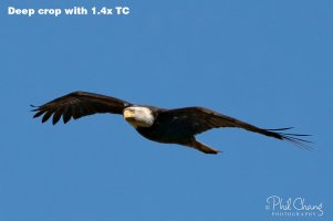

Well, I used the 1.4TC yesterday, so some comments there:
1. The size is excellent, extending the camera by just 16mm (compared to 26mm on the Canon 1.4 IIII).
2. It is a very important piece of the puzzle for Sony for now, because native lens options essentially end with it at 560mm/f8. The 2x is not a real option on the camera, because autofocus past f/8 is not PDAF.
3. Good news for Sony: The TC on the 100-400 GM has a smaller hit to autofocus speed than the Canon 100-400LII + 1.4 III.
4. Bad news for Sony: like the 100 - 400LII + 1.4 III, it's a pretty terrible Bird in Flight combination in terms of autofocus speed. But then again, the Canon combination isn't very good for birds in flight either -- not so much tracking the bird, but getting the initial AF lock, if you only have a couple of seconds and you aren't already focused on or near the vicinity of the bird.
5. The only way I could get it to autofocus was to AF on some trees at about the same distance at a lower zoom, then point it at the bird, and then letting it do its thing. Then, following the bird (using a small zone AF, like center + expanding).
6. I photographed 105 shots of two eagles circling in the air. I was very lucky: they circled for a long time. If you've ever shot eagles, when they do this, it's very easy to focus on them, because their flight pattern is relatively slow and predictable. Exposure setting was something like 1/2000, f/8, ISO 320. I was using a monopod with a sirui tilt head.
Literally ONE was in "best" focus, which wasn't really perfect, but was probably as good as I'd get with AF. TWO were very close after artificial sharpening. FOUR more were close enough to be considered good focus after artificial sharpening. 98/105 shots were garbage.
For reference, on a 6DII, my shot percentage would have been something like 60%+ in perfect focus, with or without an extender.
7. For bird portraits in a situation where the extra 40% reach lets you take a well-composed shot where the subject fills up the frame, it's excellent. In my opinion, better than the Canon, because you can focus magnify, manually adjust, and guarantee a perfect focus on the eye much easier than you can on the Canon.
8. Whites against contrast solids had CA that don't correct in post (without manually photoshoping it). Slightly OOF whites had bad CA, worse than without the extender. It is also small enough that if your subject fills up the frame and you can resample that image down to typical distribution sizes from the original 42mp, it will disappear.
9. IQ was generally pretty good, but it definitely suffers a little. If I could split the difference and get 20% closer to the subject, I would rather do that than to use take the extender, with the 40% magnification. This, based on some heron shots (though the extender shots were in a different location as the non-extender shots). Note that this is no different than the Canon.
Attached is the best shot I could get out of 105. It was photographed using uncompressed RAW (so, 85MB file), 1/2000, f/8, ISO 320. It is cropped, but not resized, and sharpened as best I could in LR.
This image has a long edge of about 1800 pixels, so it's not exactly a deep crop, though it's still a significant one. That said, I am able to get very good 1500-2000 pixel bird crops out of a 6DII with the 100-400LII with or without the extender, definitely superior to this one. But I will try some more, and report back.

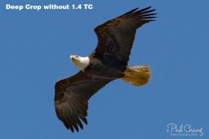

AlanF said:
Phil, thanks for more testing. To my eyes, both eagles are very soft, and they are over-sharpened. I can do better than that with a Canon 100-400mm II + TC.
I couldn't agree more, on both points. I'd have deleted them had they come out of my 6DII.
The autofocus for birds in focus is simply a waste of time, except for the very specific circumstance where the bird starts stationary (eg perched), and takes flight laterally where the AF doesn't need to adjust.
I took about 1,000 more BIF photos today, mostly with the TC, and a few without; With the TC, it was awful. Without, it actually went pretty well. I'll post up some of the shots when I get a chance.
With the TC, I was able to get some great photos of larger subjects, like dogs -- so, I suspect, it is an acceptable wildlife lens combination, just not for small, moving subjects, like birds.

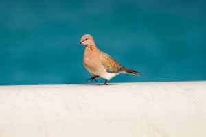

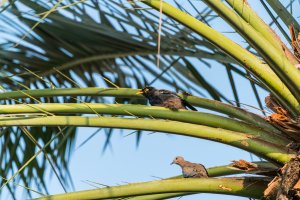

Thanks Talys and Neutral for removing any GAS I had for the Sony. I am always on the hunt for better gear. Last time, I bought on-line the A7RII because of the rave reviews, and sent it back after two days as the SF wasn't good enough with Metabones and other factors. The reviews on the A7RIII then said that it was the camera the A7RII should have been, with better AF etc. It's so easy to be swayed into buying, and you you can't trust reviewers so it is just so helpful when Forum members give their real and honest experience
I was looking seriously at the Panasonic G9 as it had such rave reviews and the new Elmarit 200mm f/2.8 is a stunning lens. But, thinking about it, you realise it has not much better resolution than a 5DSR and hardly any more than a 24 mpx Canon APS-C. Then, you start seeing seeing the odd throwaway line in otherwise rave reviews: "you can't expect Canon AF"; "The lens does hunt rather too much" etc. Only Nikon could tempt me away for bird photography, but they don't have a 100-400mm II or a 400mm DO II, so Canon, you have me hooked, as the 200-500mm is heavy and not as good as my Canons for BIF, and nothing compares with the DO.
Attached is FE100-400 with 1.4x extender on Sony a7r2 , full frame and 100% crop.
560mm ,1/1000sec, f8, ISO1000
Also earlier shots ,a7r2 with Canon 100-400 with 1.4x III extender using Matabones IV adapter, I posted it here some time back
Also at 560mm, camera was in crop APC mode to cut off not required from frame.
Both Canon and Sony 100-400 with 1.4x extenders are top-notch performers.

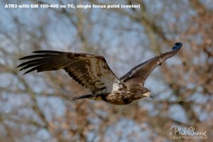

I have some additional photos that are better, and that describe some of the problems with the camera for me, personally.
1. First of all, in the first photo, I used center point + expanding points on the dog. I've highlighted the center; yet you can see how the AF picked up the grass. There's really no excuse for this. It's much worse for bird portraits, because a stray leaf that you can't see will grab autofocus if it's closer to the camera.
2. Here is the best deep crop with teleconverter that I could get with the TC. Note that I took over 1,000 photos that day, and the vast majority (like 99%) were garbage. The shadows on this photo were not recoverable without adding unwanted artifacts.
3. Deep crop without the TC - this one is actually pretty good, I think. My ratio of in-focus shots without the TC went up dramatically without the TC, and using center point only. The only problem is that it's hard to know WHERE to focus, because 90% of the time, I couldn't see anything at all, and without a distance scale or a way to manually rotate focus, all I could see in blue sky was, well, unfocused blue. I ended up AF on trees at approximately the distance, then spot the bird. The problem is, if the center spot wasn't right on the bird, BOOM. Blurry blue, again with no bird, and no way to find it. This is just not an issue with Canon.
Setting the AF range to 3m-infinity definitely helps, and I'm rarely getting within 3m of any subject anyways when birding.
4. But all is not lost - with single focus point, it is possible to get some relatively good shots, even with a busy background. It works with center + expanding, too, as long as NOTHING will get in front of the bird.
I give up on the subject tracking. Yes, it looks so nice to see in the viewfinder that my bird is being tracked by the camera. It's so impressive that it can be anywhere in the VF, and apparently in focus. There's a green box around it right? I can lock on the bird somewhere in the VF, and it tracks as the bird flies towards me and blow that beautiful buffer... that's 16 uncompressed frames at 42 megapixels, with a nice, juicy one at the end that's tons of pixels wide of bird!! Buuuuuut... when I check... most of the time, the first or second frame looks pretty good, and the next 14 are all OOF unless it's a panning shot, where focus barely changes anyways. Maybe not horribly OOF, but not good enough to keep.
That's using the 8fps drive speed that Sony recommends (instead of 10).
My general impression is: the TC is a no-go for birds in flight, and adapted lenses just don't focus quickly enough. So if you want > 400mm for BIFs, the Sony A7R3 isn't the right choice.
Without the TC, it's tolerable. It is a compromise, because you can get gorgeous bird portraits, that are perfectly focused on every shot. But at least for me (and I'll concede that I'm sure I'd get better if I stuck with it), I'd have to give up a decent chunk of in-flight photos, which are much more exciting when I do get to capture them.
