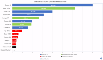

"(<0.8 microsecond read time)"
Is this perhaps meant to be milliseconds? 0.8 milliseconds would still be industry leading. Microseconds is 1000 times faster.
Borrowed from a AlanF post:
And doing some math, but the R3 was reported as having 1/180th sec readout time, which is 5.5 milliseconds. The R5 was reported as ~1/60th readout time, which is 16.6 milliseconds, slightly different than above, but the same ballpark.
Reactions: 13 users
