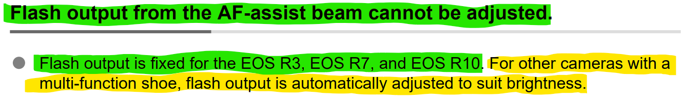

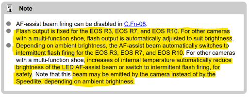

I feel like the higher end speedlites will have the new MFS. But lower end speedlites will have the old hot shoe. Also not all cameras with the MFS support automatic adjustment of the LED AF Assist Beam. So the camera will emit an LED AF Assist Beam or the speedlite will switch to Intermittent Flash Firing. So there's a gotcha. So you get a "compatible" LED AF Assist Beam but your limited to a fixed brightness level. Then you don't know if the speedlite will switch to Intermittent Flash Firing. Or if the camera tries using its own LED AF Assist Beam. You can't set which beam is emitted the camera decides. Canon EL-5 AF Assist Beam Protocol .png

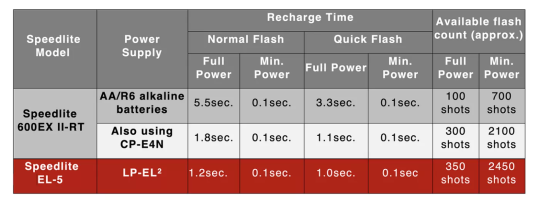

Do you think this speedlite will be as good or better than the EL-1.
If I may, it's to be considered an "EL-1 junior," so technically not as good as the EL-1.
"The two flashes share some key features, including the same high-speed charging circuits and overall flash power. The two flashes are both 76Ws and have the same guide number of 60m/197 ft. at 200mm (ISO 100)."
"However, where the two flashes differ is in their inclusion of active cooling. The EL-1 has a built-in fan to keep the flash cool and let it fire 335 consecutive flashes. Without the built-in fan, the EL-5 delivers about 95 consecutive flashes. The EL-5's full power recycling time is 1.2s, which is 0.3s slower than the EL-1."
Price-wise, the EL-5 could be a better bang-for-your-buck as it has many of the features of the EL-1 for considerably less money.

Agreed, and the EL-5 launched at a price 30% cheaper than the 600EX II-RT. It does make the EL-1 look overpriced by comparison, and I expect we’ll see an EL-1 MkII sooner rather than later, with the multifunction shoe and a lower price.
For those who need long stretches of repeated flash firing (e.g. paid event photographers), the EL-1 is the way to go. IMO, for more casual users the EL-5 is a better choice. Even then, close to 100 full power flashes in rapid fire isn’t slouching.

My friend's mom owns the EL-1 and is a wedding photographer. She also feels like the EL-1 is kind of extreme when the 600EX-RT or 600EX II-RT could do the job. But the Intermittent Flash Firing AF Assist Beam drains the batteries fast. Especially in the the 600EX-RT & 600EX II-RT speedlites. She went through 4 LP-EL batteries at her last wedding. The 600EX series goes through close to 20 AA batteries. The camera didn't even try using its own LED AF Assist Beam.
