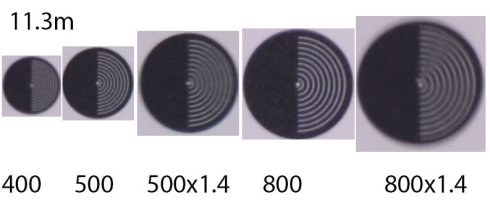

My favourite charts are those that have circles of closely spaced fine lines or finely spaced close parallel lines at different separations so you can see when they can no longer be resolved. I have made a collage of the smallest circles from group 3 at 11.3m as they are closest to fine spacing, and it is quite informative. You can see that the 400mm is just able to resolve the lines, but the rest are well resolved. They also detect some shake or shutter shock when the 1.4xTC is attached, and this is making the 500mm at 700mm look worse. You can see it also see the horizontal shake at 700mm where the vertical lines are much worse than the horizontal elsewhere. I don't think it is astigmatism of the TC as the apparent shake is in a different direction when on the 800mm.

It does look good at 800mm. Thanks again.
