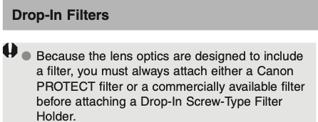

I just got a lens that has the 48mm PL-C drop in insert filter in it. I would much prefer just the normal 48mm filter insert. So, I guess this post is to ask two questions, both of which I'm pretty sure I know the answer to, but one of which I don't really want to accept the answer to.
1) I noticed that there is a thin snap ring holding the filter in place. I removed the snap ring, and it's easily possible to remove the polarizing filter from the holder entirely, leaving just an open hole. Since this is the only 48mm filter holder I have, I assume it's fine to just use it without the filter in place for the 95% of the time that I don't want a polarizer?
From the instructions:

I heard somewhere else that using a clear filter in these cases is always recommended. Looking around a little more, it seems that using no filter at all may inhibit the lens's ability to focus at infinity? I took a photo of the moon the other night with no filter, and I was pretty happy with the result. That's about as infinity as it gets. Aren't lenses generally designed to be able to focus a little past infinity to account for tolerances anyway?
I gotta say, despite Canon's recommendation, if my only reasonable choices are to use a polarizer all the time or no filter at all, I'm going to prefer no filter because I can't really perceive a big problem with the lens function when running no filter.
